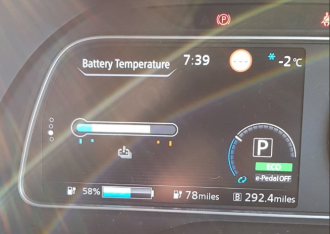

            Tu je obrazok z toho nabijania. Nechapem ako moze byt bateria prehriata ked je vonku -2. To ako naporove chladenie pri jazde nefunguje?

              na husto natrepane na sebe clanky, vacsi dojazd = viac odpadoveho tepla, vacsia bateria chladne pomalsie. Moj 30 kWh sa mi prehrieva az po tretom DC (v zime, v lete som este nemal auto)
            • Ioniq
              Ioniq komentoval
              Upraviť komentár
              Jux tu spominal, ze 40kWh batt pack sa zahrieva pomalsie oproti Ioniqu kvoli hustote. Tak kde je pravda?
            • Jiri GrandPa
              Jiri GrandPa komentoval
              Upraviť komentár
              To je možné ale to auto malo za sebou 292 míľ a jedno rýchlonabíjanie bez vychladnutia. Ale bolo -2(!). To ako čo bude robiť keď bude +30?

            Phil Gordon Starting tempSpravovať
            Phil Gordon
            Phil Gordon 1st charge, starts at 11% and gets to 80% in 46 minutes.Spravovať
            Phil Gordon
            Phil Gordon Temperature after 1 rapid charge.Spravovať
            Phil Gordon
            Phil Gordon Arrival at second rapid, estimate from 12-75% is 90 minutes!Spravovať
            Phil Gordon Charged at the second rapid to 65%, moved on to avoid traffic. Hit the 3rd rapid here.Spravovať
            Phil Gordon Sorry for the multiple posts but I can only add 1 picture at a time.
            Basically I left the dealership with a full battery, battery temp around 30% of the bar.
            Drove 100 miles and charged from 11-80% in 46 minutes. On arrival at that rapid my battery temp was already up to about 60%.
            Leaving the first rapid the temp was up to around 70%.
            Drove another 100 miles and arrived to rapid number 2. Battery temp now around 80% and just before the red lines. Plugged in and got an estimate for 12-75% of 90 minutes!
            Due to time and traffic I only charged to around 65% which took nearly an hour. Battery temp stayed at that 80% region.
            Charged again a little later, again the estimate was huge and the charger only pulled 22kw.
            Something is very wrong with this car.
