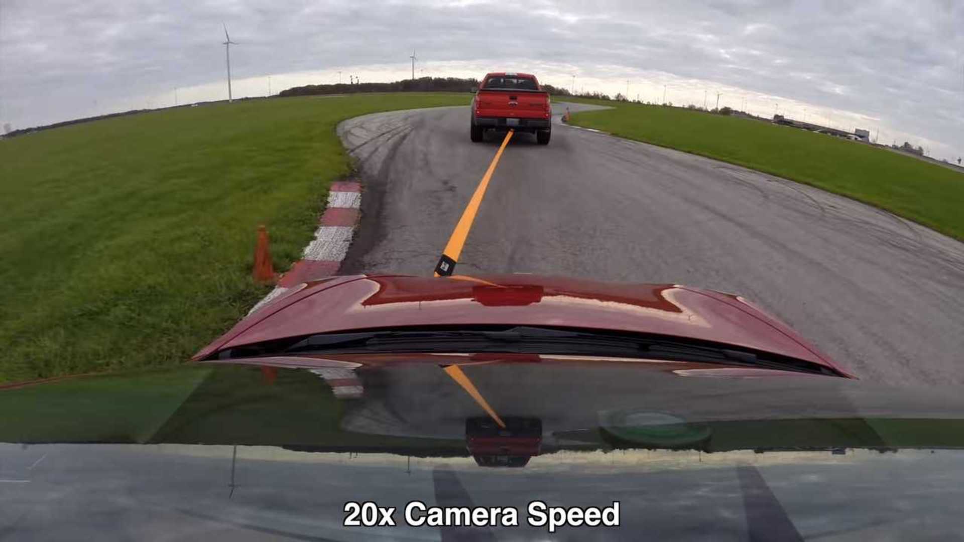

    Samozrejme, ze sa da, je o tom kopa videi... no vyrobcovia BEV spravidla (az na vynimky) zakazuju tahanie.
    • jux
      jux komentoval
      Upraviť komentár
      napr.:
      A Model X owner in Norway towed a Model S and recorded the whole thing, with the latter car shown to be charging via the re-generation effect in the process
      https://insideevs.com/news/382196/ra...odel-3-towing/
