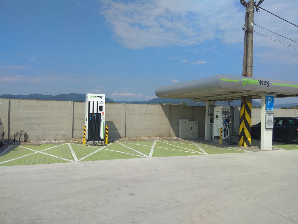

    DALITRANS TN
    Veľké Bierovce 266
    Popis:
    DC: 1xCCS 150 kW, 1xCCS 50 kW, 1xCHAdeMO 62,5kW, 1xCHAdeMO 50kW
    AC: 1xTyp-2 43 kW, 1xTyp-2 22 kW
    GPS: 48.853641 ,17.964671
    Platba: Spoplatnené, na kartu.
    Ováracia doba: 24/7
    Prevádzkovateľ: GreenWay
    Email: dispecing@greenway.sk
    Tel: +421 911 668 770
    Webstranka: www.greenway.sk
    Na mape:
    Foto:
    Click image for larger version  Name:	dalitrans.jpg Views:	393 Size:	144.5 KB ID:	59090
