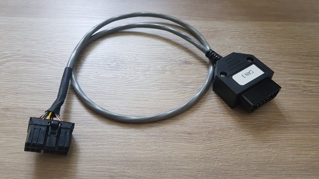

      Tak a mam kabel pre Model S 2012 - 09/2015, OBD2 bluetooth adapter by som este mal niekde v aute mat. Ostava uz len stiahnut appku TM-Spy alebo Scan my tesla. Heh vlastne aj auto este chyba ale tak to mam pre pripadnu kupu a overenie stavu baterky.

        Aky OBD modul mas? treba kvalitny, najlepsie si pozriet doporucenia na:
        There are 2 main categories of Bluetooth OBD adapters that work with scan my tesla: ELM327-based adapters STN1110-based adapters Also, there are the currently supported 'Panda' devices: JWardell CanServer Enhauto/S3XY Commander ELM327 are your standard cheap adapters. They do a great job on older
        Doporucuje OBDLink® MX Bluetooth alebo o nieco lacnejsi OBDLink LX Bluetooth. Ja mam verziu LX a funguje v poriadku. Lacne OBD nebudu v Tesle fungovat.

        Fuha diky za link to som si ani neuvedomil. To moje urcite spada do tej kategorie lacnych a este ma aj X rokov. Asi pojdem do toho LX aj ja. Odkial si ho kupoval ?

        Nechcelo sa mi cakat, tak som kupoval OBDLink LX Bluetooth v alze. https://www.alza.sk/auto/diagnostika...SAAEgJ4qPD_BwE
