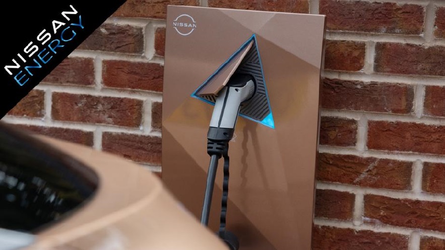

      Takže priame V2F ( bidirectional direct HV/DC to HV/DC ) tj bez drahých meničov nehrozí ani po roku ?
      Ale čo sa týka V2G tak sa to asi pohlo
      Under the banner of Nissan Energy, the company’s aim is to roll-out V2G technology in the UK first, followed by other markets in Europe, empowering consumers with either AC or DC-based V2G solutions, in alignment with local infrastructure and regulatory requirements.
      Existuje už aspoň nejaká dvojica ( EU auto+ wall box ) ktorá vie home 3f V2G aspoň bez schopnosti predaja do DS ?​
