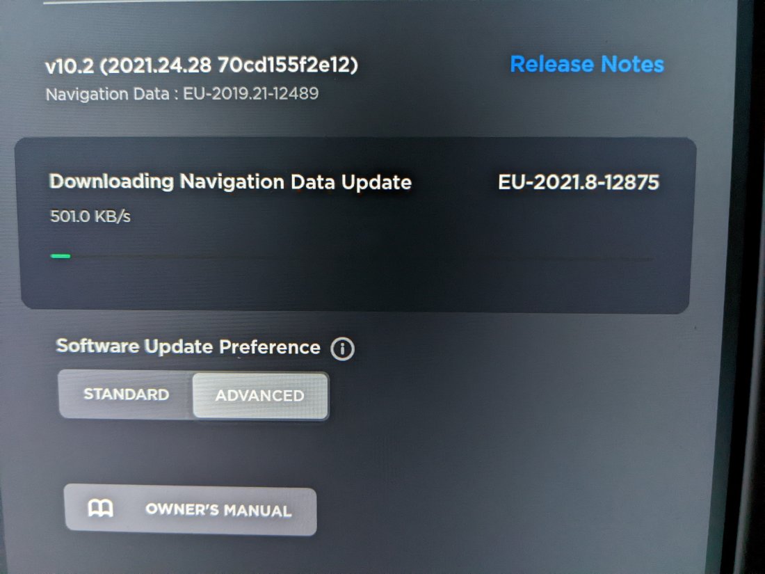

    #4
    Update navigacie predsa prisiel - Model S 2015 s MCU1:
