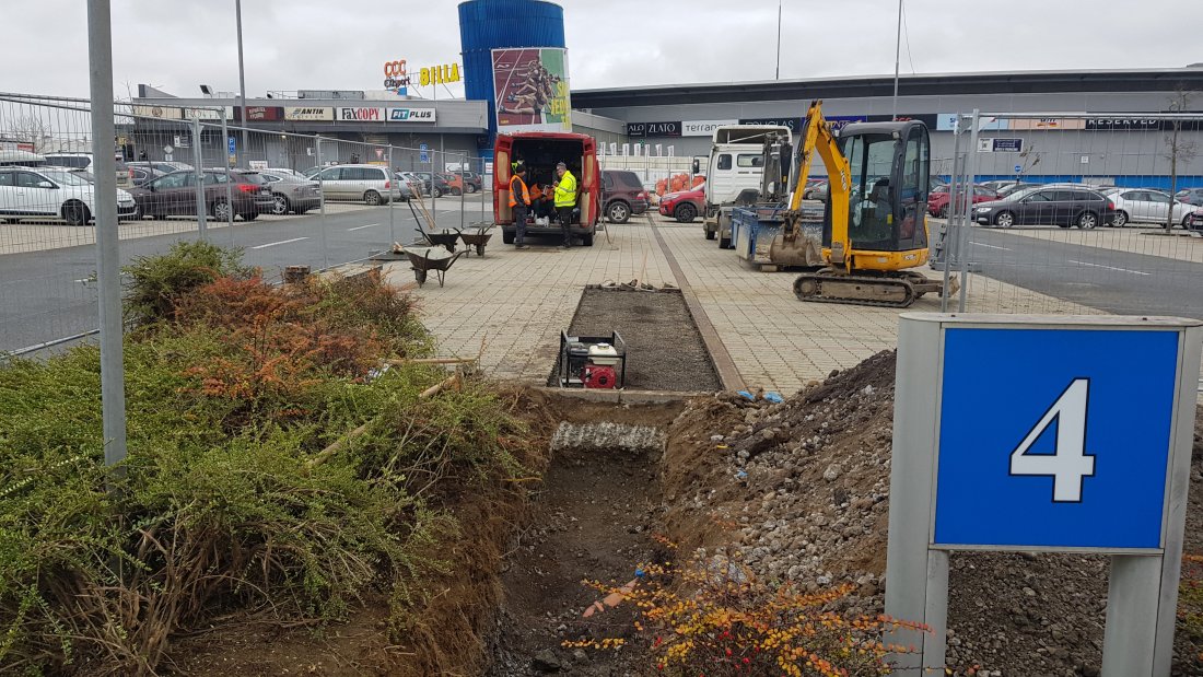

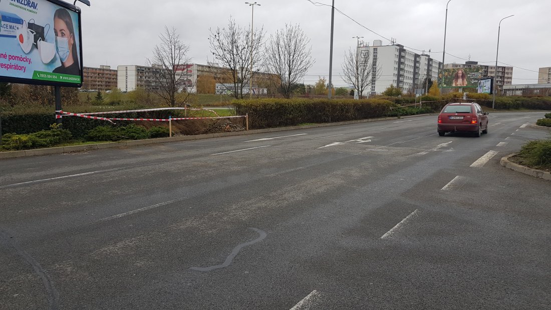

      Pokial nieje topic v nabijackach a uz ked sme aj tak dost off-topic v tejto teme tak pridavam aktualne Supercharger Kosice foto:
      Click image for larger version  Name:	20201112_121727.jpg Views:	0 Size:	211.7 KB ID:	63830
      Click image for larger version  Name:	20201112_121746.jpg Views:	0 Size:	172.2 KB ID:	63831
