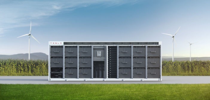

              Po Powerwall a Powerpacku prichadza Megapack
              https://electrek.co/2019/07/29/tesla...orage-product/
              After Tesla’s worldwide success with Powerpack battery grid installations, the company has now designed and engineered a new battery product called the Megapack made specifically for utility-scale projects. This larger battery pack has a 60% increase in energy density over the current Powerpack and boasts up to 3 megawatt hours (MWhs) of storage capacity per […]
              Mit einem neuen Produkt will Tesla seine Energiesparte voranbringen: Das Megapack soll eine rasche Installation von großen Speicherkraftwerken ermöglichen.
Meno:	tesla-megapack-2-e1564477434824-702x336.jpg
Videní:	753
Veľkosť:42,1 KB
              • Wilo
                Wilo komentoval
                Upraviť komentár
                Pekna hromadka baterii. Ale na dvor prilis male. Pockam si na Gigapack
              • ICE666SVK
                ICE666SVK komentoval
                Upraviť komentár
                Podla Tesly sa to sprace na nakladne auto vlak ci lod a tym sa to rychlo moze presunut kamkolvek. Ma to kapacitu 60 baterii Tesly model 3 SR a v porovnani z inymi rieseniami to ma vyssiu energeticku hustotu, nizsie naklady a priestorove poziadavky a rychlo sa instaluje.
