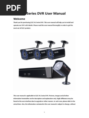

Elec camera network setup sales
Elec camera network setup sales, How to set up ELEC Security System YouTube sales
Elec camera network setup sales
How to set up ELEC Security System YouTube
Configuring Remote IP Cameras Cornick
Setup ELEC CCTV Camera System YouTube
ELEC HL Series DVR User Manual Welcome PDF Port Computer
How to setup a security camera system on the network
IP Camera Network Setup Steps Diagram Screenshots Video
Product code: Elec camera network setup salesELEC HD Security Camera System Review YouTube sales, ELEC HD Security Camera System Review sales, How to set up ELEC Security System YouTube sales, Configuring Remote IP Cameras Cornick sales, Setup ELEC CCTV Camera System YouTube sales, ELEC HL Series DVR User Manual Welcome PDF Port Computer sales, How to setup a security camera system on the network sales, IP Camera Network Setup Steps Diagram Screenshots Video sales, Manual CCTV Sirius 8 PDF File Transfer Protocol Port sales, ELEC HL SERIES USER MANUAL Pdf Download ManualsLib sales, Complete CCTV Camera Connection Diagram with NVR CCTV Camera Complete Wiring Diagram with NVR sales, How to set up a network camera a.k.a. IP camera sales, IP Camera Network Setup Steps Diagram Screenshots Video sales, How to set up ELEC Security System YouTube sales, How Do I Add Networked Cameras to an Imperial NVR sales, Setup ELEC CCTV Camera System YouTube sales, What is CCTV and Why Do You Need it Mech Elec Group Ltd sales, QK AS07 N2K NMEA 2000 GPS and Heading Sensor sales, ERL SOHO Printing and DLNA not connecting between subnets sales, CCTV Smart Heating Controls North West sales, Port Forwarding and Remote Access Setup Guide for IP Cameras sales, ALECTO ELEC IDC 25 INSTALLATION MANUAL Pdf Download ManualsLib sales, CCTV Camera Wiring Diagram and Connection for Installation with sales, ELEC e Cloud DVR remote monitor setup sales, ELEC CCTV DVR Camera s setup YouTube sales, 5 Methods on How to Connect a Security IP Camera to PC Mac sales, LUM 300 CUB IPW WH 300 Series Cube IP Indoor Camera White sales, ELEC HD Security Camera System Review YouTube sales, Network communication unit DL series KEYENCE UK Ireland sales, CCTV Smart Heating Controls North West sales, How to connect your security camera to the Internet sales, Furniture store camera layout help Ubiquiti Community sales, Connect Your CCTV Device to the Internet DVR or NVR 6 Steps sales, One man show r VIDEOENGINEERING sales, CCTV Network Example How To Create CCTV Network Diagram sales.
Elec camera network setup sales
- elec camera network setup
- toscan v380
- arlo go rechargeable battery
- simplisafe camera colors
- finicky world v380
- install v380 on pc
- v380 in google play install app
- arlo go customer service
- minano cctv setup
- v380 app pc
